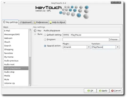

or use "key touch" Download Here
This can configure ALL your special keys.
