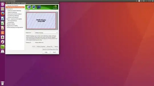

Make sure that the NVIDIA graphics are in use in the NVIDIA X Server Settings -> PRIME Profiles.
In case they are not in use switch to them, logout of the session and back in or reboot the system.
Now re-attach the external monitor to the HDMI port and it should be recognized right properly.

Judging by the output of your lspci, you and I have the same laptop, which should make this hopefully easy.
You need to have the latest Intel graphics drivers installed on your system. To do this, visit Intel's page and install the version for Ubuntu 16.04.
From there, run the Graphics Update Tool to install all the relevant Intel drivers, followed by a reboot of your system to allow the new drivers to take effect.
Also ensure that your BIOS has SecureBoot disabled to avoid any weird driver conflicts that have been known to happen. You must also have NVIDIA's latest drivers installed (at the time of writing, 378). You do not need to set it to the active PRIME device.
