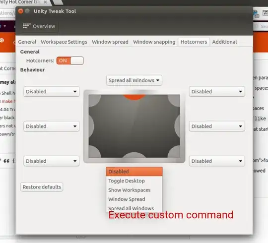

Is it somehow possible to run a custom command on a hot corner as shown below?

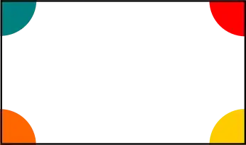

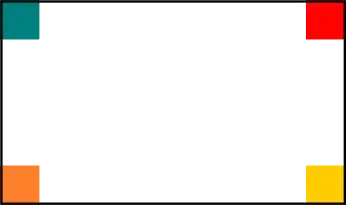

Furthermore, you can set the size of the hot corner in the line:
cornersize = 10
Simply change the value (pixels). The script sets (square) areas to trigger your commands:

If we use a bit more advanced computing, we can use a radius instead of a square area to trigger the commands (thanks to good old @pythagoras):
Small difference, but just for fun:

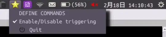

The indicator is controlled via ~/.edger-commands.json file , obviously in json format. It can be written manually by the user, or set via indicator's DEFINE COMMANDS option. The enable/disable triggering option is remembered and written automatically to file for user's convenience. Sample configuration file would be like so:

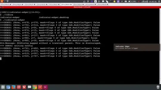

Once the indicator detects that user has placed the mouse along any of the edges (with ~3 pixel margin), the indicator will send a bubble notification and run the appropriate command (if defined). Activation of the trigger won't repeat unless the user moves the mouse away from the edge.
As you can see from the screenshot above, the indicator also has debugging output in the command-line. If you find any bugs, feel free to run it from the terminal, find out what error occurs, and submit appropriate bug report on issues page of the project's GitHub.
