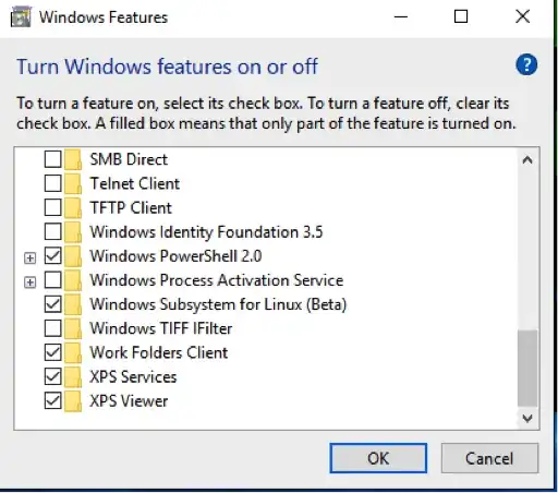

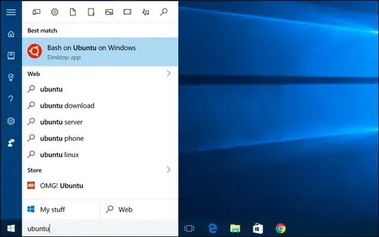

There is another option that let's you run ubuntu inside1 Windows 10 Pro. Since Windows 10’s Anniversary Update (Windows 10 Anniversary Update build 14393) you can install Windows Subsystem for Linux.
This will install the desktop edition however. However the differences are small between desktop edition and server edition and are within reach with some instructions.
It is currently in beta and not Ubuntu server by default. There a some applications that won't work (as well) as on a "real" ubuntu machine 1
This is the first release of a brand new technology. There will be gaps. We know some of them, and we’re certain you will find many more. Again, this is a beta release – expect things to fail. Some tools will crash and/or not run. But please be sure to let us know when you run into issues – we’re working hard to fix problems and dramatically improve WSL over time.
