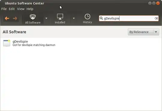

Installed in 11.10 Using Ubuntu Software Center...
