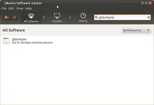

First download and install gDevilspie (I used Ubuntu Software Center)

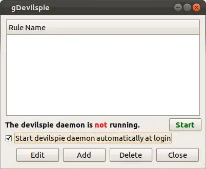

So start the application so its window is open, then fire up gDevilspie...

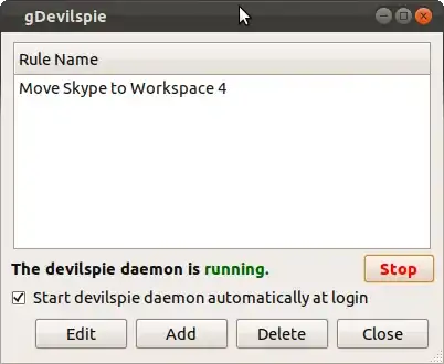

Click the ✔box so the daemon will startup at launch and then hit the add button...

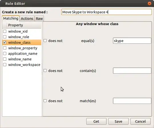

Now give our rule a name.
Then identify the application's window for the new rule using its properties. Two ways to do this:
  1. Hit the Get button and be presented with a list of window_names, or
  2. Find the window_class using xprop.
The 2nd way is safer because window name can change. Open a terminal and type in xprop | grep WM_CLASS The mouse cursor will change to a plus. Move the new cursor so it's over the desired application window, and click it. The wm_class will appear in the terminal...

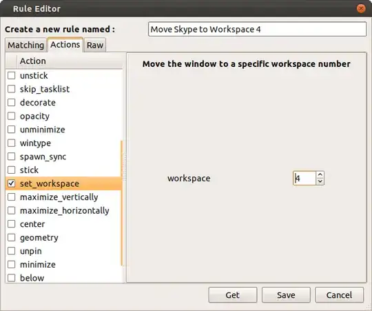

Now click the Actions tab, and check the ✔box for set workspace then set the desired workspace...
If you like, check out the rule...
Now save the rule using the Save button...
And start the daemon if it's not running already.

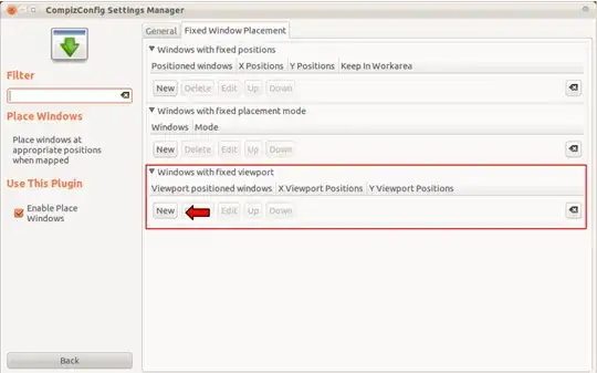

You can use Place Windows plugin of Compiz (CompizConfig Settings -> Window Management section -> Place Windows):

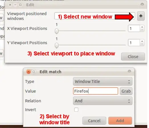

And then choose the window and viewport (in this example, i choose Firefox):
Also, if you want that window to start maximized you can set that in Windows with fixed placement mode.
