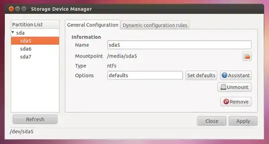

If you want a graphical tool, use PySDM
sudo apt-get install pysdm
PySDM
