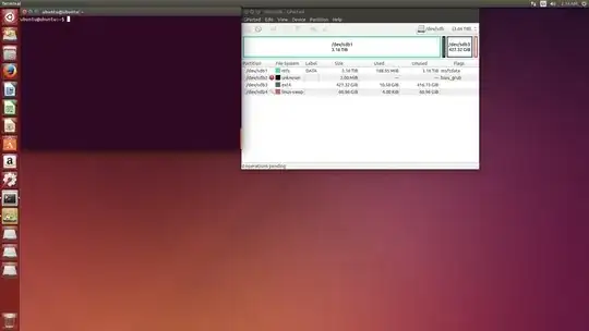

So, it was brought to my attention that using a GPT partitioned drive for Grub requires a dedicated Grub partition. I was previously unaware of this because that particular information appears as a short paragraph in the Grub installation instructions (https://help.ubuntu.com/community/Grub2/Installing#BIOS.2FGPT_Notes) but is not in the general Ubuntu installation instructions. At this point, I have put the 4TB drive back into the new computer and have resumed attempts to install Ubuntu on it. However, despite following the online instructions to the best of my knowledge, Grub still does not work. Based on the boot info, the previous issue of a missing image file appears to have re-emerged. The following boot info is from after an attempt to purge and reinstall Grub. The screenshot shows what GParted displays when examining the 4TB drive. When installing Grub, during both Ubuntu installation and Grub reinstallation, I select sdb as the installation location for Grub.
http://paste.ubuntu.com/23958163/
Screenshot with GParted showing the 4TB drive partitions

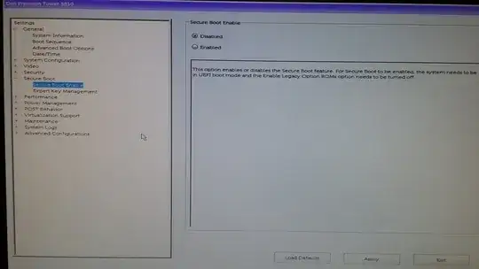

As requested by oldfred, I have checked the Secure Boot settings. I am working on Windows 7 Enterprise so msinfo32 does not display this status. However, I was able to check by accessing the boot settings upon booting the computer. If anyone knows a simpler method, feel free to share. Regardless, below are two images showing the current Secure Boot configuration for the computer in question.
Image of computer screen showing legacy ROMs enabled
Image of computer screen showing Secure Boot disabled
