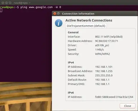

Some other observations:
  • I AM connected to the networks that I try to connect to, it seems, and the device is assigned an IPv4 address.
  • Entering an url in firefox is not loading anything, however. Also pinging won't return anything.
  • Even though I was able to access the internet when I first installed 16.10, I currently cannot access any sites even when using a clean live USB to "try out Ubuntu".
Here is a screenshot showing that a network is connected, but nothing is coming through ping:
Any suggestions? Many thanks!
