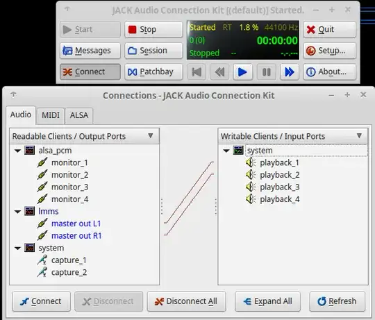

I had to use the jack connection app to get audio to work, ALSA wouldn't do anything. I'm on Mint 17.3(ubuntu 14)
$ sudo apt-get install qjackctl
then run with
$ qjackctl
it seemed to wire up the connection automatically. Try restarting LMMS after you start jack if you get problems. enter image description here

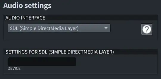

The default settings of LMMS did not work on my Ubuntu 16.04 either, but I changed its audio API to SDL (Simple Direct Media Layer) and it worked fine.
Setup LMMS
