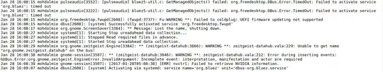

Here is the image from var/log/syslog

I experienced a similar problem. I am running ubuntu 16.04.1 with Kernel 4.10.0-30-generic.
I replicated the bug on another distro using a different kernel 4.9 -- debian stable lxde running from a live usb.
After reading many fora and going through several logs, I realised this is nothing but the c-state kernel bug, or at least it has the same solution.
The steps described by Doug solved my problem.
