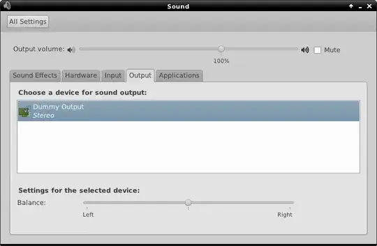

Update 1: As pointed out by fossfreedom in the comment, the issue seems to be in the device for sound output. Somehow my real devices have been replaced with a "dummy device". How can I add my on-board sound device to this list? enter image description here

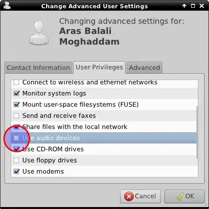

Update 4: This is getting interesting. I thought I found the solution when I saw that my user did not have permission to use the sound device. enter image description here

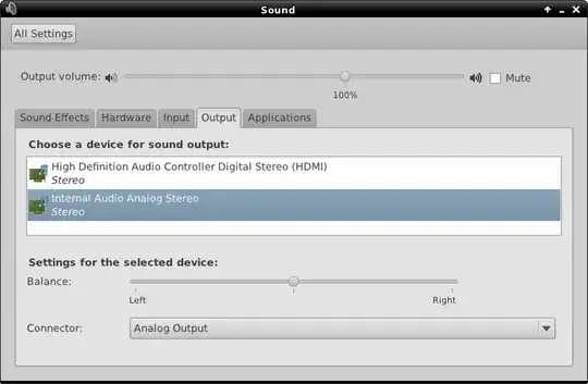

So I add myself to the audio and video groups and rebooted. Now the sound devices are available under choose a device for sound output. enter image description here With lots of hope I selected Internal Audio Analog Stereo as the device, but still no sound at all is coming out of the system :(. I tried using the speaker test tool as well as playing music while trying out all the different jacks. I also tried switching between HDMI and the Internal Audio, still no luck. What else can I do next?
