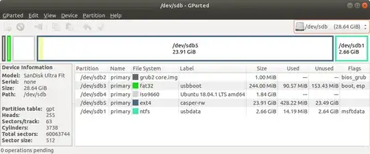

  • Use mkusb to make a Live system on the Installer USB (2GB or larger).
  • Use mkusb to make a Persistent system on the Target USB using default settings with ~25GB persistence if available, (remaining NTFS partition is used as Windows accessible data partition).

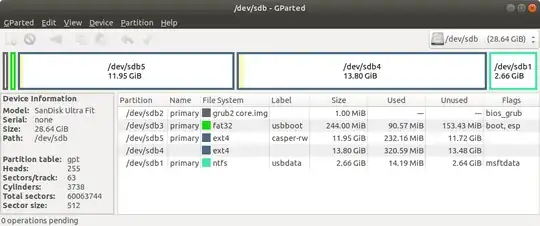

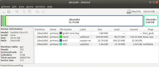

  • As soon as mkusb finishes, open GParted and delete sdx4, the ISO9660 partition and expand sdx5 into the recovered space, (sdx being the device name of the Target drive).

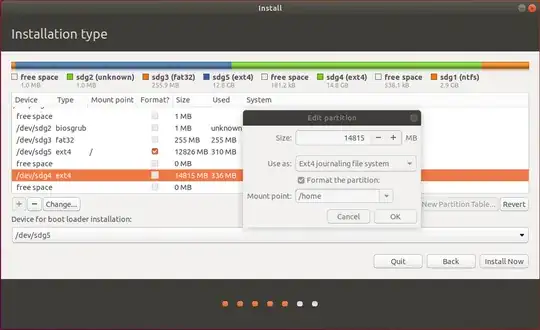

  • Create a extra ext4 partition sdx6 for /home if a separate home directory is desired, (Optional).

  • Start Install Ubuntu...
  • Select "Something else".
  • Select sdx5, (on the target drive), and click Change.
  • Select Use as: ext4, Format and Mount point: /.
Don't touch any other partitions (unless adding an optional /home partition to sdx4).
  • Select sdx5 as Device for boot loader installation.
  • Complete installation.
