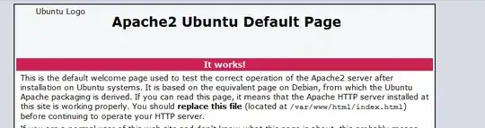

I'm trying to set up a small VPS. When it was provisioned for me I was given the ip address , which dispays an apache2 page. I'd prefer to set things up using nginx. I asked the host about switching to nginx and got:

But the default page is still visible at the url. What am I doing wrong?

No change . I also edited text in the index.html file and this is being served correctly.

root@server:/var/www/html# lynx http://localhost
I still see the webpage in the lynx browser

root@server:/var/www/html# sudo lsof -i tcp:80 | egrep LISTEN
nginx   28487     root    6u  IPv4 603899449      0t0  TCP *:http (LISTEN)
nginx   28487     root    7u  IPv6 603899450      0t0  TCP *:http (LISTEN)
nginx   28488 www-data    6u  IPv4 603899449      0t0  TCP *:http    (LISTEN)
nginx   28488 www-data    7u  IPv6 603899450      0t0  TCP *:http (LISTEN)

Thanks for the output. Your original command for stopping the service worked perfectly.
The page you are seeing is an instance of a web service running on a different machine.
You'll have to use your DNS services to point to the machine you are assigning for your web server.
You can also verify this by running a web browser on your local machine (the same one you are starting the apache2 server on) and load this address in your web browser:
http://localhost
The resolution is to setup the virtural hosts for your Apache server, then configure your Name Server to point to the IP address of your configured Virtual Host.
Running your browser on your local machine to load http://localhost will fail when you stop the service (your original command). It'll load the default page when you start the apache service on your local machine (replacing stop with start from your original command.
According to your question updates and comments, you are running two web servers... Apache2 and Nginx. Running them both on the same ipaddress/port will be a conflict because it would lack a method of determining where to send the data.
As per your preference of Nginx, you can disable Apache with:
$ sudo update-rc.d -f  apache2 remove
