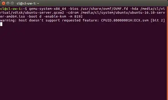

When you execute the command, the terminal looks like that (Do you eventually mean this with qemu-system-x86_64 hangs ? Don't add an option which prevents a new window to be visible) :
qemu-1

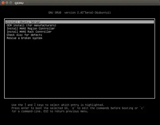

A new 'QEMU terminal window' opens, showing the expected option to install Ubuntu from the installation media (Note : this is an example from my setup - so the boot options are different) :
qemu-2
