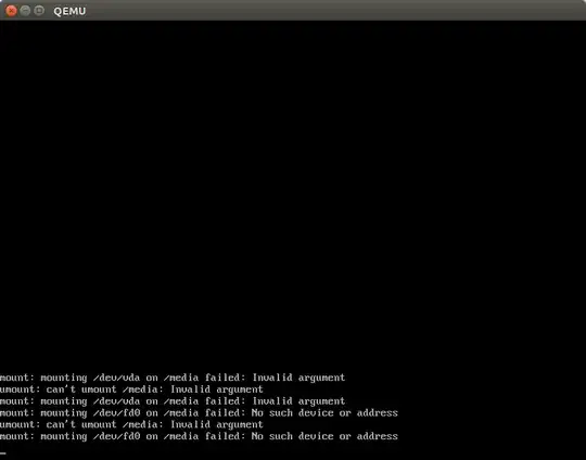

But when I'm installing the virtual machine I get
mount: mounting /dev/vda on /media failed: Invalid argument
unmount: can't unmount /media: Invalid argument
mount: mounting /dev/fd0 on /media failed: No such device or address
messages in terminal

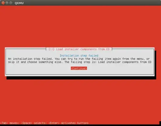

And at the end, it reported:
An installation step failed. You can try to run the failing item again from the menu, or skip it and choose something else. The failing step is: Load installer components from CD.
dialog popup in terminal
