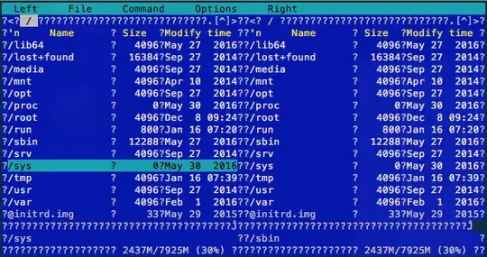

Today I logged into my Ubuntu server and noticed that Midnight Commander looks different:
strange question marks
Furthermore, I can't use functional keys (Mac keyboard with Fn key).
I tried to reinstall it, but with no luck. Can anybody help to fix this?
GNU Midnight Commander 4.8.11
Ubuntu 14.04.4 LTS (GNU/Linux 3.13.0-53-generic x86_64)
$ echo $TERM
ansi
I'm using macOS Teminal with oh-my-zsh.

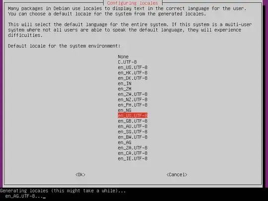

Make sure at least one locale (of an appropriate language and region) that is marked as UTF-8 is selected on the first screen. You will have to scroll down (arrow keys). Spacebar selects or unselects an item, Tab switches between the list and the "buttons" below it, and Enter does roughly what you'd expect (it performs the default action for whatever is selected).
Configuring locales (screenshot), selecting locales to install
I've selected en_US.UTF8, but any UTF-8 locale should work. The first two letters, before the underscore (_), represent the language, and the letters right after the underscore represent the country.
Probably it will not look quite like that to you. Like mc, dpkg-reconfigure may display * characters instead of the characters it uses to draw the border. But this is purely cosmetic -- you should still be able to select and configure locales through this utility.
After you've pressed Tab and Enter to "click" the Ok button, you'll have to select the default locale. Make sure this is a UTF-8 locale (and that it's of the language and country you want). Move up and down with the arrow keys and press Enter when you get to the one you want. This will be set as your system's default locale, and all enabled locales will be (re)generated.
Configuring locales (screenshot), choosing a default locale
