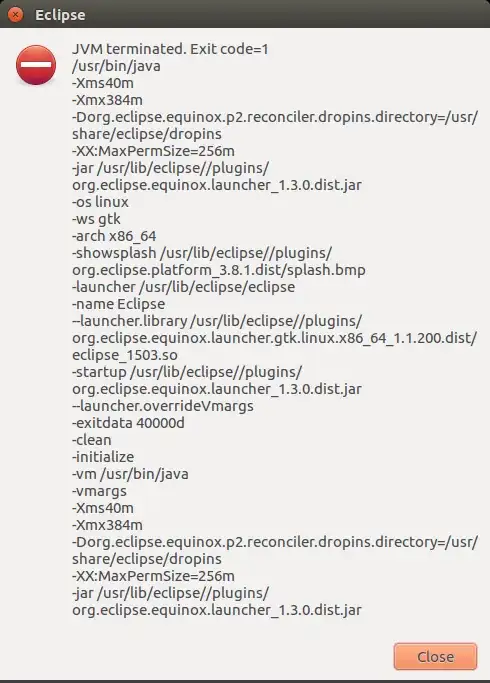

I am running Ubuntu 16.04 I have installed openJDK via synaptic and also eclipse via synaptic. Everything was working fine. However suddenly I am getting this error when I try to open eclipse.
error code
How to fix this?

The content of my eclipse.ini is:
 -startup
plugins/org.eclipse.equinox.launcher_1.3.0.dist.jar
--launcher.library
plugins/org.eclipse.equinox.launcher.gtk.linux.x86_64_1.1.200.dist
-showsplash
org.eclipse.platform
--launcher.XXMaxPermSize
256m
--launcher.defaultAction
openFile
-vmargs
-Xms40m
-Xmx384m
-    Dorg.eclipse.equinox.p2.reconciler.dropins.directory=/usr/share/eclipse/dropins

Upon review of your eclipse.ini file it seems that we haven't specified a specific Java Virtual Machine to run eclipse on. This is appears to be a common stumbling block. Let's remove the uncertainty by explicitly stating which VM to use by placing the -vm argument in your eclipse.ini
It's always a good idea to make a backup if you aren't entirely certain what you are doing, so from the directory containing your eclipse.ini make a copy with cp eclipse.ini ~/Documents/eclipse.bak which will place a backup in your Documents directory.
Locate the version of java you intend to launch this may help and if the results are confusing this post should help provide clarity. Don't skim, read both the accepted and highest rated answers
Specify the full path to the vm your trying to launch.
Example your path is likely different:
-vm
/opt/sun-jdk-1.6.0.02/bin/java
Place the appropriate lines for your installation directly before the -vmargs line as shown in the Specifying the JVM section here
