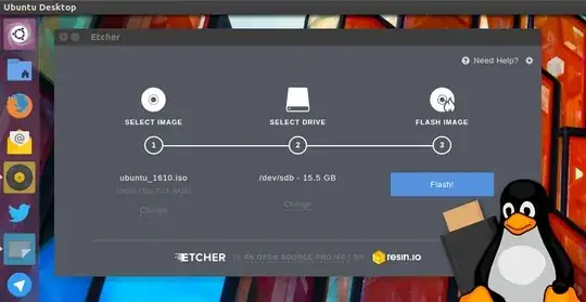

if you just want burn image easy to USB drive.
You can use etcher as alternative unetbootin
i like this for simple UI
etcher
