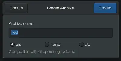

How can I get more options (in addition to zip, tar.xz and 7z) and the option to add password when making archive files in file-roller in Gnome 3.22? Thanks!
Screen-shot of new create archive in Files (nautilus) 3.26.0 enter image description here

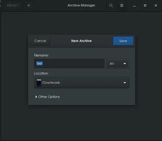

Archive Manager (file-roller) enter image description here

Try this:
Set a password to encrypt data in a new archive by following these steps:
Start creating a new archive.
At the bottom of the file chooser dialog you can choose a File Format and enter a password into the Password field in Other Options.
Choose an archive type that can be password protected before setting a password.
Continue with creating a new archive.
Protect an existing archive by setting a password:
Open an archive.
Click Edit ▸ Password….
Type a password into the Password field.
If you want to encrypt the list of files tick Encrypt the file list too.
Click OK to continue.
Archive Manager will encrypt only new files which will be added to the archive!
