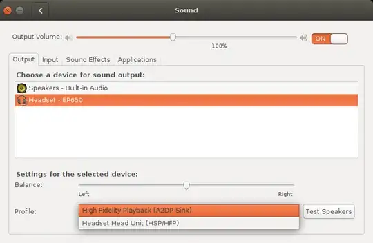

  5. Check sound options to see if you are using the correct output device. If your experience a garbled audio mess, make sure you have Hihg Fidelity Playback (A2DP Sink) enabled.
Sound settings to enable output device and playback profile a2dp
