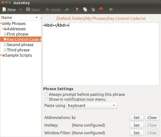

I did some googling and found a program called AutoKey (Autokey - Linux utility for text substitution hotkeys) near the top of the list.
Rather than a hotkey using Ctrl+Shift+K I chose to assign the abbreviation kz which is automatically expanded into <kbd></kbd>+.
It is simply installed using:
sudo apt install autokey-gtk
It installs in Launcher and the screen is pretty simple to use:
Autokey

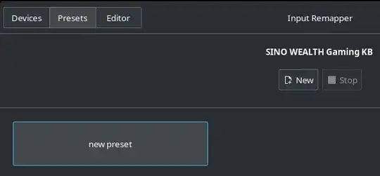

  1. Click "new preset"
input-remapper-gtk presets

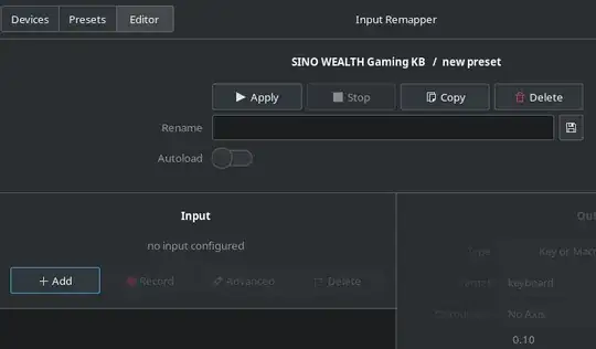

  1. Click "+ Add"
input-remapper-gtk editor add

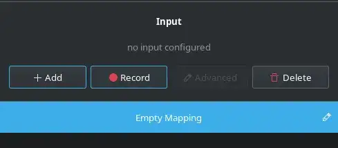

  1. Click " Record"
input-remapper-gtk editor record

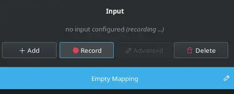

  1. Press Ctrl+Shift+k or what you would like to bind
input-remapper-gtk editor recording

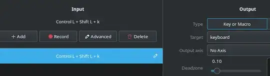

  1. Select "Key or Macro"
input-remapper-gtk editor output

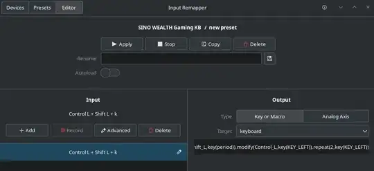

  1. Enter modify(Shift_L,key(comma)).key(k).key(b).key(d).modify(Shift_L,key(period)).modify(Shift_L,key(comma)).key(slash).key(k).key(b).key(d).modify(Shift_L,key(period)).modify(Control_L,key(KEY_LEFT)).repeat(2,key(KEY_LEFT)) . See more examples
  2. Click "▶️ Apply"
input-remapper-gtk editor done
