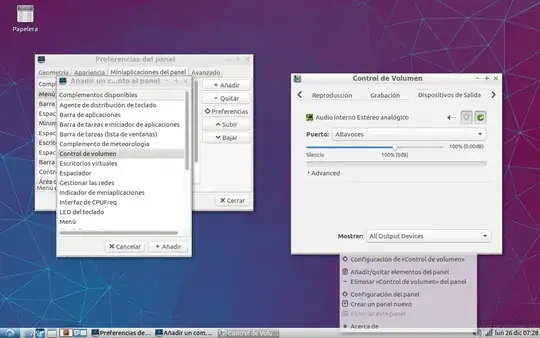

In order to get the Lubuntu/lxde sound icon in panel, as it's the default config of a fresh install, right click on the panel and select "add elements to the panel".
In this window you will select the"Add" button and search for the "volume control" applet.
Put it in any part of the panel you want and after this you can right click the icon and select "configuration" which will open alsamixergui or pavucontrol if you installed it.

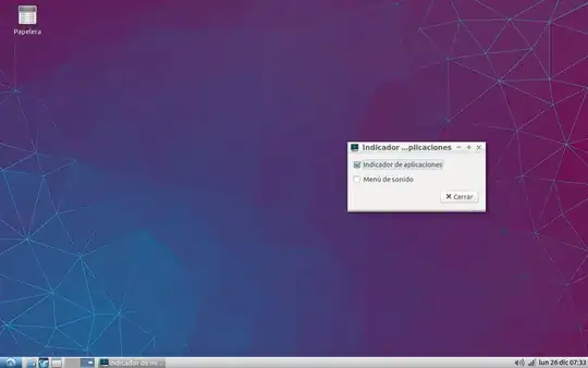

You can then right click the notification INDICATOR area and disable the sound menu indicator.
