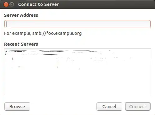

Open Nautilus and find the Menu item "Connect to server".
Under Server Address Enter:
sftp://server_user_id@192.168.x.yyy/home/server_user_id

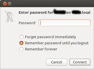

Press Connect. You will see a password dialog box:
Enter the password associated with server_user_id and select if you want the password is to be remembered or not. Again click Connect.
Now you should see your home folder of the laptop.
