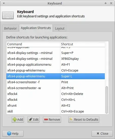

Go to the Application Shortcuts tab in the keyboard settings, create a new shortcut and copy the command that is triggered by Ctrl+Esc (the default shortcut for the Whisker Menu).
As of Xubuntu 16.04, the command you have to enter is xfce4-popup-whiskermenu:
screenshot of keyboard settings on Xubuntu 16.04

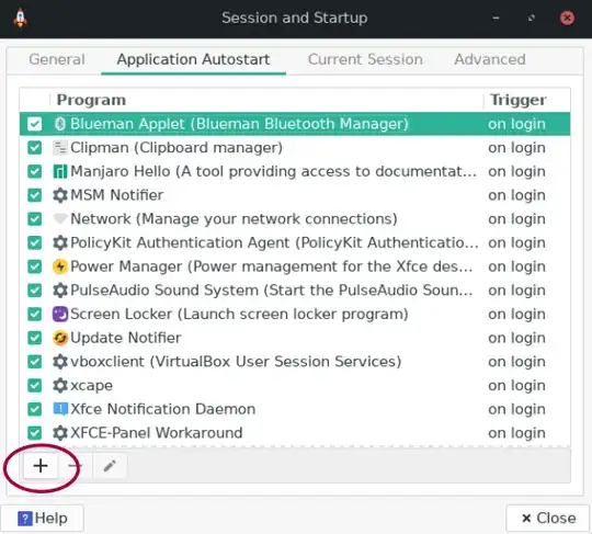

  2. Open Session and Startup and go to the Application Autostart tab.
  3. Press the + button to the lower left of the window to add a new application.
    Session and Startup

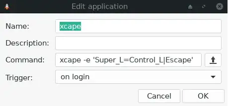

  4. In the Edit application window that opens, add the Name and Description (optional) that you prefer and the following Command, with Trigger set on login (also see screenshot):
    xcape -e 'Super_L=Control_L|Escape'
    Edit application
  5. Click OK.
