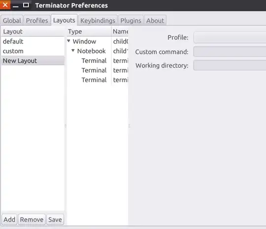

Original answer
Terminator has a layout preference, which you can use with specific number of tabs, splits, and assign specific color profiles to them. What you want to do is to open window , add how ever many tabs you want, and then right-click, go to Preferences , layouts tab, and click add button
Once you're done editing layout, save it. Now you can call use terminator -l <Layout Name> to spawn window with that exact set of tabs. For instance, from my screenshot you can see I have custom layout, so I would use terminator -l custom
