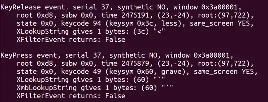

enter image description here shifted keys: enter image description here

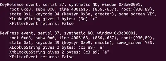

IMO, it is a really trivial solution because the issue is deeper. Having determined that which are greater,less, eacute, grave, I have exchanged them from the keyboard layout C file(tr for me) on /usr/share/X11/xkb/symbols/. enter image description here
