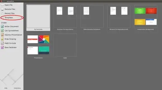

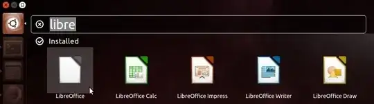

You can start LibreOffice (the plain launcher, not e.g. LibreOffice Writer directly).
starting LibreOffice launcher
There, instead of clicking on "Create Writer Document", you can click on Templates and select a template from the list appearing on the right to open a new document based on that one:
creating a new document from a template

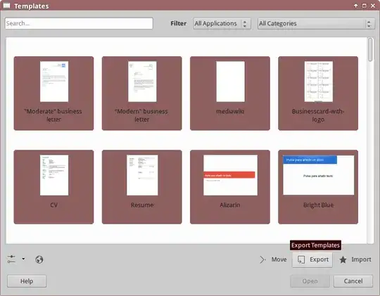

Export from LibreOffice
The following steps are required to do only once. Preferably using LibreOffice 5.3 or newer, as some information may not be applicable to older releases of LibreOffice.
  1. Open LibreOffice (or run libreoffice from Terminal or the application launcher).
  2. In the sidebar, click Templates > Manage Templates. The "Template" window will appear.
  3. Select the first template, then press Ctrl+A to select all templates (Notice that selecting none or all will disable the open button).
LibreOffice Templates
  1. Click Export button. The "Select Path" dialog will appear.
  2. In the file dialog, select a directory of choice and click OK to confirm. All templates will be exported (copied) to there, then a small dialog will appear when successfully exported.
LibreOffice Template exported

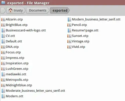

  1. Close all windows of LibreOffice to finish. Then, open target directory i.e. ~/Documents/exported in File Manager to confirm that all template files were exported.
Exported Templates in File Manager
As a result, you will have all template files (with file extension *.otp,*.ott) in the directory of choice. For LibreOffice 5.3 that was installed manually, there are 21 template files in total.

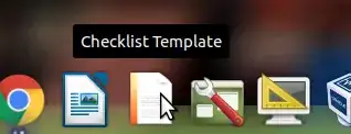

Let's say you want a single button/menu entry to open your checklist template...
cd /usr/share/applications
sudo cp libreoffice-writer.desktop libreoffice-writer-checklist.desktop
sudo pluma libreoffice-writer-checklist.desktop
pluma, nano, vi or any other editor of your liking.
Into that new .desktop file:
[Desktop Entry]
Version=1.0
Terminal=false
Icon=/usr/share/icons/Humanity/emblems/48/emblem-documents.svg
Type=Application
Categories=Office;WordProcessor;
Exec=libreoffice --writer /home/frank/.config/libreoffice/4/user/template/checklist.ott
Name=Checklist Template
GenericName=Word Processor
  • The original .desktop file had tons of translations you don't need, thus removed.
  • of course, you can also pick any other icon (just check our /usr/share/icons/, i.e. ctrl-F and find all .svg, turn on Thumbnail view to identify a nice one)
  • namepath to your .ott file and your home directory of course varies (after all, now that you explicitly give the path, you don't have to play by any libreoffice conventions, can be home/joe/herearetemplates)
  • btw: my original libreoffice file was a little messed up, had the Exec= key twice, just look out.

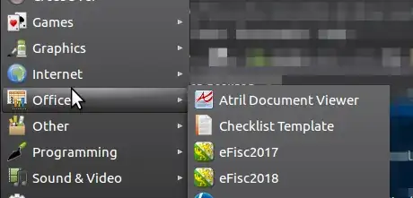

et voilĂ
Your new application should appear in the menu right away. And if you open /usr/share/applications in your file manager (i.e. caja) you should be able to create a link onto your desktop, add it to the top bar panel or as I do onto your plank:
Repeat for any other template you need (easier to start with your newly created, shorter .desktop file).
