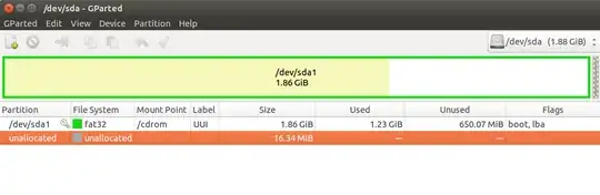

I am blocked because the installation program cannot find 8.6Gb of free space on my hard drive despite the fact that there are hundreds of Gb free according to Windows. Digging a bit into the problem, it seems that Ubuntu cannot see my hard disk at all.
This is the output of GParted: output of Gparted
I am not sure what that drive mounted at /cdrom is, but it seems the only device that exists in the system that is not a RAM disk or a loop device:

I am blocked at this point. Any help will be much appreciated.
