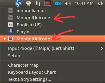

I added some input methods using IBus before. After I upgraded to Ubuntu 16.04, though, they stopped working. (If I select them I just get normal English input.) I just want to get rid of them now, but I don't know how.

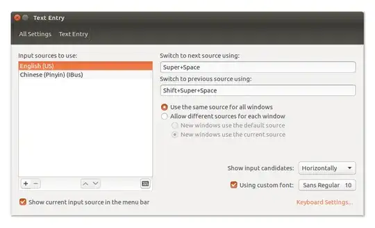

I tried going to System Settings > Text Entry but the mongolianipa and MongolUnicode ones that I want to get rid of are not listed.
Where is the menu generated from? Is there some settings file or database that I can edit?

The only noticeable problem is that it creates a double entry in the menu.
I am able to input text with the new input method. When I remove the input method in Text Entry Settings it disappears from the menu. However, the old one is still there in the menu.
