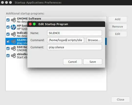

Step #4: Type startup applications in the Dash and add the path of silence.sh script to it.
So, basically what we are doing is listening to events of headphones been connected and disconnected and playing or stopping the blank mp3 file in a loop. Now, I have used mplayer because I know that I am never gonna use that for any other purpose and killing its process is completely safe for me.
