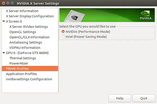

I use the NVIDIA binary driver 367.57 selected in the "Additional Drivers" tab in "Software and updates". It works perfectly, except that the option "Prime" is not showing in NVIDIA X Server Settings. What should I do ? Should not Prime be automatically installed with the 367.57 drivers ?

Maybe the installer did not recognize that the computer has a hybrid graphics solution.
Normally the package nvidia-prime should be installed alongside the NVIDIA drivers automatically - to do it manually, open a terminal and execute the following command :
sudo apt install nvidia-prime
Now you can find the tab PRIME Profiles in the NVIDIA X Server Settings application.

nvidia-prime is its own separate package that needs to be installed.
sudo apt-get install nvidia-prime
