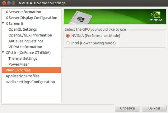

You need to have both Nvidia proprietary drivers and nvidia-prime to get it working. This can be done by running
sudo apt-get install nvidia-346 nvidia-prime
for Ubuntu 14.04 and 15.04.
Then you will have Nvidia X Server Settings in Dash. And there you can find PRIME profiles.
