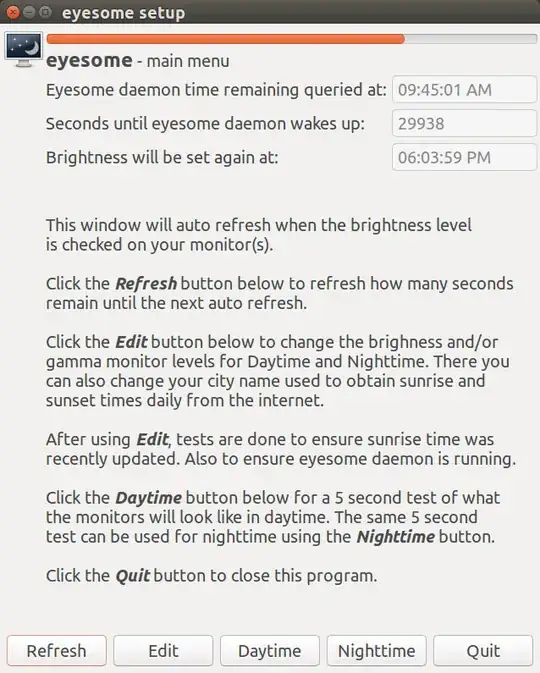

Eyesome Setup - Main Menu
To configure eyesome, a main menu is provided:

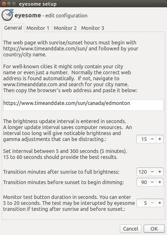

Edit Configuration - General tab
When you click the Edit button from the main menu the edit configuration general tab initially appears as shown below.
Your country/city name should automatically appear. If necessary you can override it.
