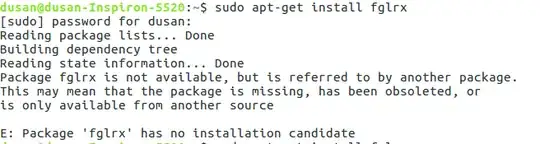

Where can I find and how can I install the latest graphic drivers for Dell Inspiron 5520?I`m using 16.04 LTS Ubuntu Gnome.
When I use sudo apt-get install fglrx this appears

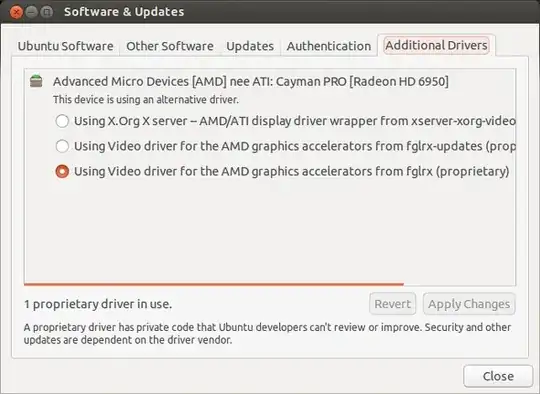

The easiest way to install binary drivers is to use the built in Additional Drivers manager in Ubuntu.
Select the fglrx(proprietary) and click apply changes(You might need to enter your password).
After the fglrx driver is installed, reboot your system and login. To check whether the fglrx driver is working, open a terminal and type:
