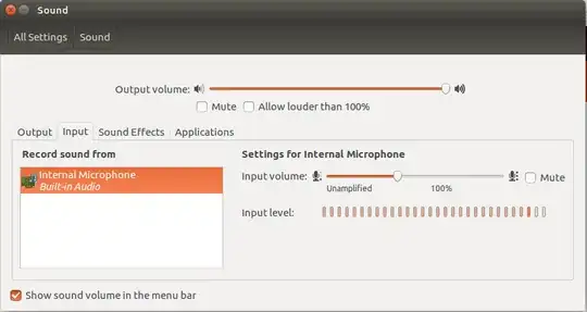

I just decreased the input volume bar in here. And it worked!!!
System Settings→Sound→Input
