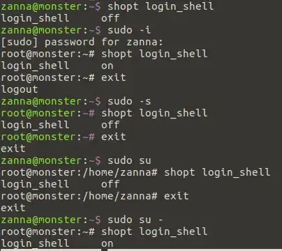

As @Serg explains in this answer on how to tell what shell you are running, the SHELL variable is just the current user's default shell as read from /etc/passwd:
$ grep zanna /etc/passwd
zanna:x:1000:1000:Zanna,,,:/home/zanna:/bin/bash
so if I echo $SHELL it will always return /bin/bash:
$ zsh
% echo $SHELL
/bin/bash
Whether or not the shell is a login shell, is a shell option determined at the time the shell is started. The shell program stores this information along with all its other settings and variables. The shopt command provides a way to see this information and, if possible for the option in question, to set or unset it (this isn't the case for login_shell which, of course, depends on the process used to start the shell)
The sudo program's options determine how these different types of root shell will be started:
Zanna
  • 72,312
