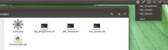

Use a tiny indicator that automatically adds your scripts to a menu
Instead of creating multiple watch- procedures for each and every possible event that could take place, I'd suggest using a "one for all" solution like below.
The indicator script automatically adds your scripts to the indicator menu, if you place them in the same directory as the indicator. This way your setup scripts will be easily available from the GUI.
The indicator

How to use
  1. Copy the script into an empty file, save it as showscripts.py
  2. Copy the icon below (right- click -> save), save it as (exactly) icon.png in one and the same directory as the script
  3. For each of your settings commands, create a small script:
    /bin/bash
    command_to_run
    Name them (no spaces), but make sure to use the .sh extension. Copy or move the scripts into the same folder as where you keep the indicator script.
    Now you can make as many menu items (scripts) as you like,
  4. Test- run the indicator by the command:
    python3 /path/to/showscripts.py
  5. If all works fine, add to Startup Applications: Dash > Startup Applications > Add. Add the command:
    /bin/bash -c "sleep 10 && python3 /path/to/showscripts.py"
Explanation
  1. When the script is launched, it lists all files in its own directory, looking for files with .sh extension. These files are made executable automatically.
  2. For each of these files, the indicator creates a menu item to run it from the menu.
