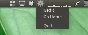

An indicator, running various commands
The answer below is an edited version of this one. Since this question is quite different from that one, decided to specify the answer there to serve in a flexible way to this question, reading both (menu) names and commands from a text file.
The solution
Is an indicator, reading lines from a file, named commands, in which both the name and the command are defined, one set per line. Name (as it appears in the menu) and command are separated by ||. An example:
Gedit || gedit
Go Home || nautilus $HOME

How to use
  1. Copy the script above into an empty file, save it as run_commands.py
  2. Copy the icon below and save it as (exactly) icon.png in one and the same folder as the script.
  3. Create a text file, also in one and the same folder, (exactly) named: commands (no extension).
  4. Populate the file with your commands and their names, like:
    Gedit || gedit
    Both the names may include spaces and the commands may include arguments.
  5. Run the indicator by the command:
    python3 /path/to/run_commands.py
