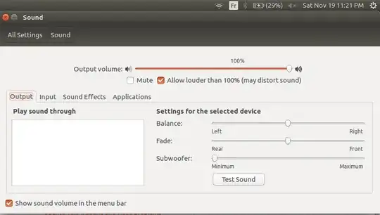

The problem is, when I restarted my computer I found that the sound was disabled and I couldn't run alsamixer in terminal to fix it as they said in step 4. I get this error :
cannot open mixer: No such file or directory
this picture could give additional information

  • This driver is outdated , uninstall it running cd alsa-driver-1.0.xx then make uninstall , reboot and hope uninstall works fine and you get the previous driver.
  • Sound is sometimes better in Windows because driver includes a builtin (and hidden) sound enhancer suitable for very small laptop loudspeaker : you can have a not-so-bad similar effect using Pulseaudio equalizer , see here
