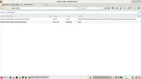

Just enable libavcodec in firefox:
type about:config in the address bar, enter
click "I accept the risk" search libavcodec
change media.libavcodec.allow-obsolete;false to true

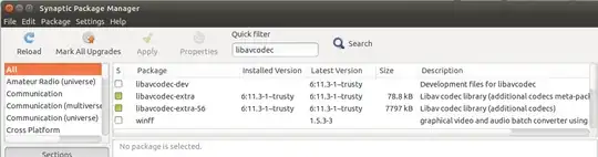

I had the same problem after update. I did that and work for me:
sudo add-apt-repository ppa:heyarje/libav-11
sudo apt-get update
  1. open Synaptic package manager.
  2. search in filter about libavcodec .
  3. check box libavcodec-extra and apply .
synaptic manager
