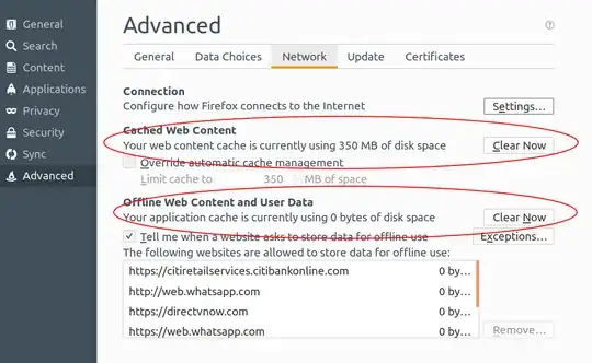

Clear your Firefox (version 52 or higher only) caches by going to Preferences, Advanced, Network tab, and click the Clear Now buttons, shown below...
