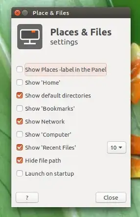

The ppa version is a modular one; you can choose what to show in the menu:
[enter image description here]

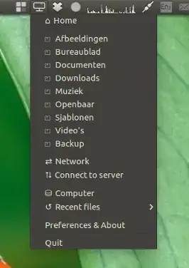

In the full version:

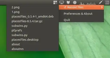

...or the smallest, only showing recently used:

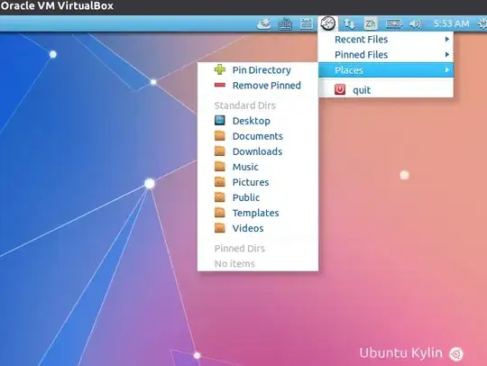

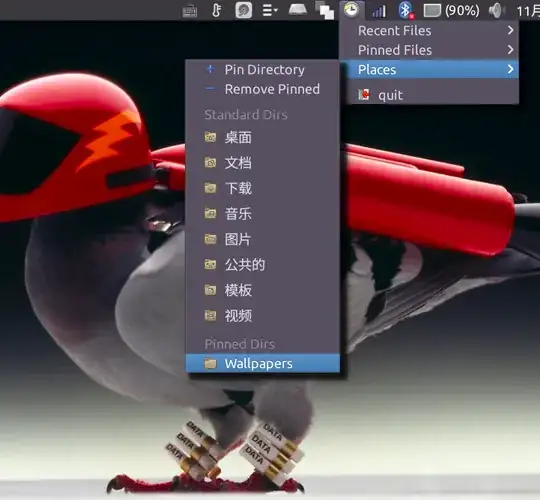

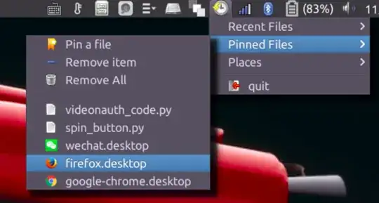

Update Feb/24/2017: the indicator now has option for pinning web links
Introduction
NOTE: The previous version of this answer can be found under the edit history, althought it is no longer relevant.
The indicator presented below has been intended for a different question, but since opportunity presented itself, I've decided to release it here. The Files Indicator is simple indicator for accessing user's files and folders. It allows checking recently used files, bookmarking files and directories. In particular, the Places menu is specifically relevant to this question.
As you can see from the screenshot, the indicator also supports locales other than English, so if your system uses something other than English, it will work.
Update: indicator now also supports launching .desktop files that have been pinned. For instance if you have firefox.desktop pinned, it will launch firefox. Thus, the indicator can be used as quick launcher for programs. The feature is on the way into PPA at the time of writing (Nov 19, 7:53 pm GMT, should take about 24 hours to process), but is already on github as well as here, in updated source code.

        places = self.add_submenu(self.app_menu,'Places')
        content = [places,gtk.ImageMenuItem,'add',
                   'Pin Directory',self.pin_dir,[None]
        self.add_menu_item(*content)
                   'remove','Remove Pinned',
                   self.remove_pinned,['dirs']
        content = [places,gtk.SeparatorMenuItem,
                   None,None,
                   None,[None]
        content = [places,gtk.MenuItem,None,
                   'Standard Dirs',None,None
        last = None
        for i in places.get_children():
            last = i
        last.set_sensitive(False)
        for dir in self.get_user_dirs():
            icon = self.get_file_icon(dir)
            content = [places,gtk.ImageMenuItem,icon,
                       os.path.basename(dir),self.open_item,[dir]
                   None,None,
                   None,[None]
                   'Pinned Dirs',None,None
        last = None
            last = i
        if (pinned_files and
           'dirs' in pinned_files.keys() and
           pinned_files['dirs']):
            for dir in pinned_files['dirs']:
                print(icon)
        else:
                       'No items',None,None
            last = None
                last = i

Configurations
The indicator is configured via two json files stored in user's home directory.
~/.files_indicator.json controls user interface , the length of menu entries and maximum numbers in the Recent Files Menu.
    "name_length": 30,
    "max_items": 10
The ~/.pinned_files.json controls the lists of pinned files and folders. Each item is a list/array.
    "dirs": [
        "/home/xieerqi/\u56fe\u7247/Wallpapers"
    "files": [
        "/home/xieerqi/work_in_progress/videonauth_code.py",
        "/home/xieerqi/work_in_progress/spin_button.py"

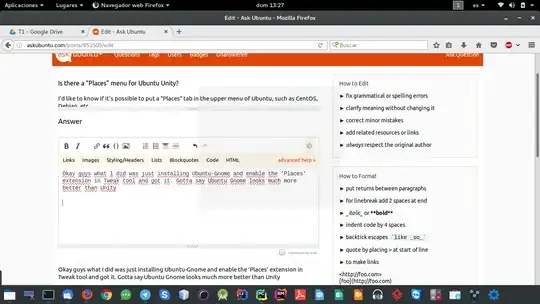

Okay guys what I did was just installing Ubuntu-Gnome and enable the 'Places' extension in Tweak tool and got it. Gotta say Ubuntu Gnome looks much more better than Unity
See the "Lugares" tab
