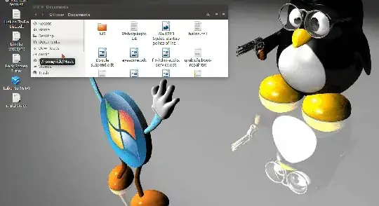

For your word processing, spreadsheet and presentation documents you can navigate using Nautilus to the directory containing the file. Then right click on the the file and select Make Link a new icon appears called Link to filename. Grab this and drag it to your desktop.
Below is an animation for a word processing document called eyesome.odt and a desktop link created for it:
After the link is dragged to the desktop, simply double click on it and the application associated with it automatically opens it.
