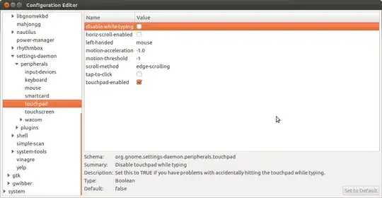

I could fix this using dconf-editor, under org > gnome > settings daemon > peripherals > touchpad. There's an option to disable the touchpad while typing.
I also don't have the "touchpad" tab in system settings. Let me know if works for you.

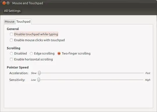

UPDATE: I've just upgraded to Ubuntu 12.04 LTS, and the "touchpad tab" issue is fixed. At least with my laptop.
Open System Settings.
Go to "Mouse and Touchpad"
Click on the Touchpad tab.
mark "Disable touchpad while typing."

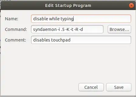

All above suggestions did not work for me on Ubuntu 18.04. I have some touchpad settings in the Settings application, but not a checkbox to disable the touchpad while typing. I did found it with dconf-editor, but it was already enabled, making no difference.
I opened Startup Applications and added syndaemon -i .5 -K -t -R -d to turn off the touchpad 500 milliseconds (.5) after every keystroke:
