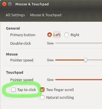

21
All Settings--> Mouse and Touchpad --> uncheck "tap to click"
Settings / Mouse & Touchpad / Tap to Click
The image is from Ubuntu 16.04 as it appears on a Lenovo Thinkpad T460.
I disabled 'tap to click'. I use the touch pad buttons for clicking. This makes my life much better with Ubuntu and Mint.

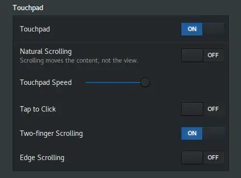

I just tried a the Wayland Gnome session on 17.04 and I noticed that it has many more touchpad options than the X11 session – including a persistent tap-to-click setting:
