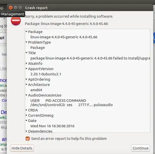

after removing kernel packages manually per user.dz's instructions paste.ubuntu.com/23487716
meanwhile during sudo apt-get install -f Ubuntu alerted me about a system error enter image description here
