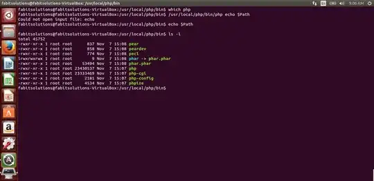

Edit:
Output of a few commands:
output of few commands
