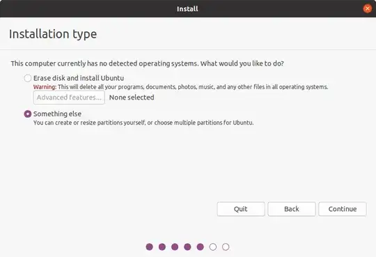

Being stuck at at creating the ext4 filesystem usually means that there is something unusual about the hard drive or its partitioning that would require you to manually partition it by selecting the Something else option at the Installation type screen of the Ubuntu installer.
