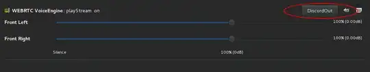

I have two applications on startup, which I link together with loopbacks and null sinks. Everything works great, except everytime I start them I have to open pavucontrol and manually change the sink/source for each application. I know there is a command to change the default sink, but that doesn't help. I want to be able to assign a sink or source to each application's input and output without opening pavucontrol. There is obviously a way to do this (as pavucontrol is doing behind the scenes) I just can't find any documentation or anyone else who has done this before.
Images to demonstrate:
PulseAudio This is the setting I want to change.

Other than canging the default sink we can move a sink input or a source output to another sink or source using pactl (or pacmd).
move-sink-input ID SINK
Move the specified playback stream (identified by its numerical index) to the specified sink (identified by its symbolic name or numerical index).
move-source-output ID SOURCE
Move the specified recording stream (identified by its numericalindex) to the specified source (identified by its symbolic name or numerical index).
To list existing streams we can issue
pactl list sink-inputs
pactl list source-outputs
These can then be moved by index to another location given by index (or name), e.g.
pactl move-sink-input 5 1
